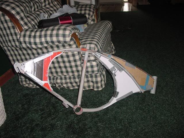

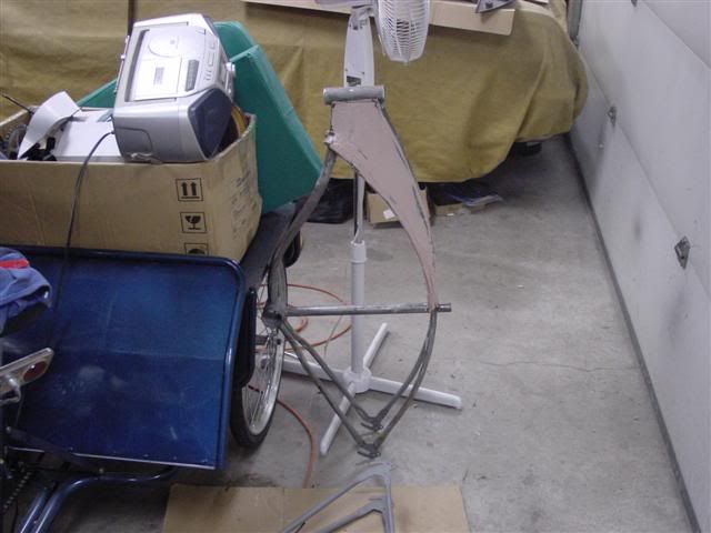

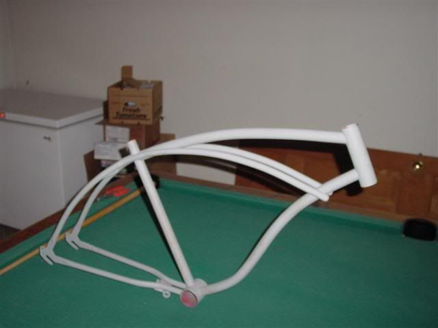

just some pics of how my progress has been going
when i was sanding the old paint down..

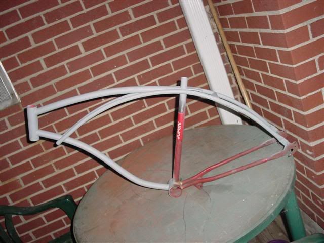

frame in primer
one of my designs

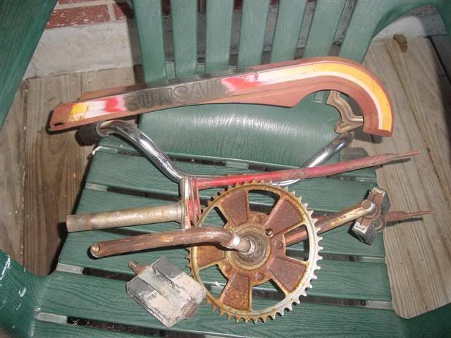

some of the old parts.. this bike was really fucked up

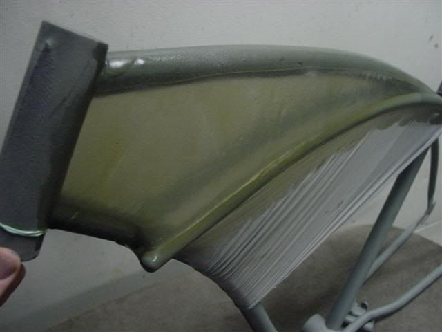

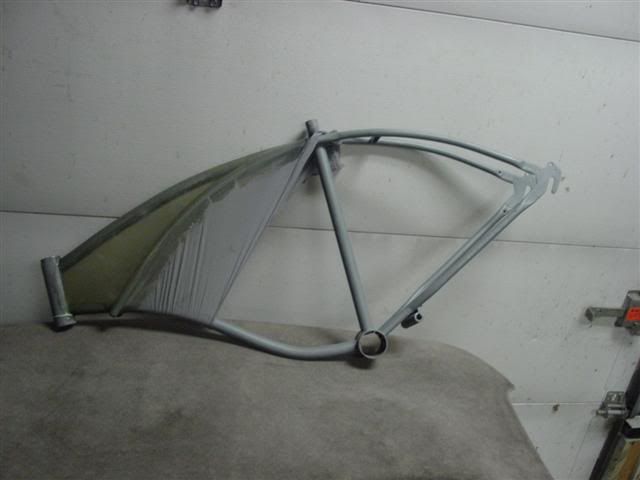

first coat of fiber glass on the tank
after about 6 coats of fiber glass and a layer of fiberglass cloth in there somewhere...all ready for bondo

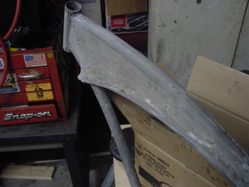

and the first coat of bondo

updates! :0
im goin with his design..
[attachmentid=231096]
some pics of it on the bike
[attachmentid=231097]
[attachmentid=231099]
[attachmentid=231101]
[attachmentid=231104]
[attachmentid=231106]

when i do fiberglass....here's how i do it (gets it done quick)
first..you need to get a little air sander..and some 2 or 3" sanding pads.
After you get your bondo on..let it harden and hit it with some 36 grit to knock it down fast. then 60..then 80. don't worry about the pinholes and stuff...the primer will fill those
when you prime it..use a high build polyester primer..and just spray it on THICK..let it run and sag and stuff...it'll fill any pinholes you may still have.
after it's dry (don't wait more then a day...just a few hours). sand it with some 80 grit. (air sander...don't forget) the primer will sand like chalk on concrete...wait more then a day and it'll be too hard to sand.
so sand the primer with 80...120..200..all the way up to 400. then wipe it down with some grease remover and let that dry..then your ready to paint!!

i think that it is pretty easy to work with.. just a little messy though
i wish i had something better to sand with
now im just having trouble getting the bono on justt he way i want it
its taking a lot more than just a day for me
