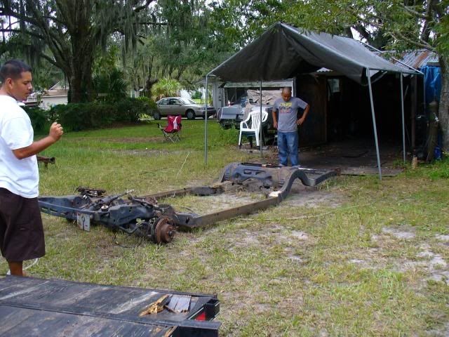

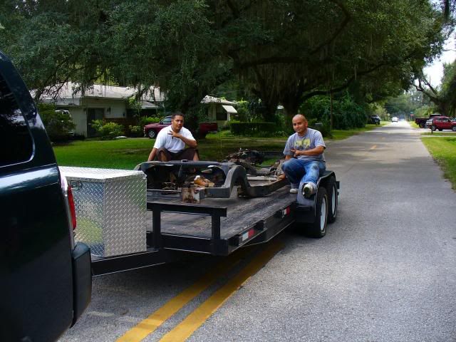

Picked up the frame from Marcos place. He coped it for 3 bills w the entire front suspension intact.
Sitting in front of my "shop" lol

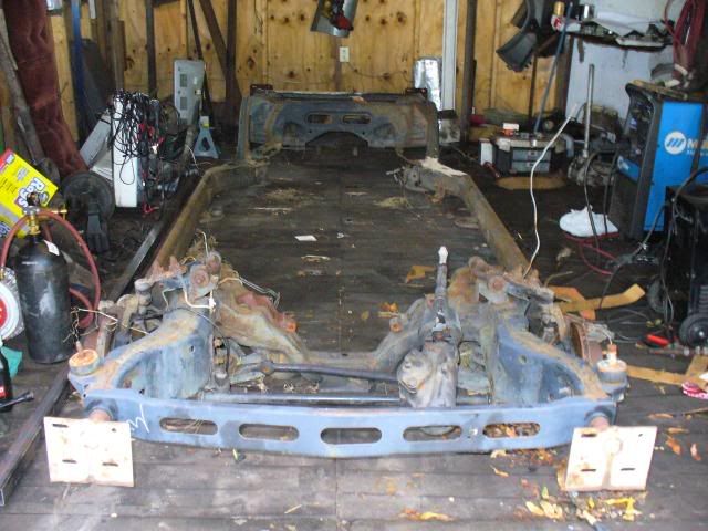

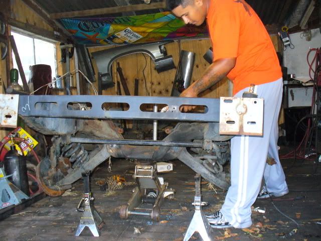

Got it in and started the stripping of the front suspension
Marcos getting dirty

Vic gettin a piece
As you can tell we didnt even clean the shop before we put it. We pretty much took one frame out and put the other in. Heres the other frame coming out.
