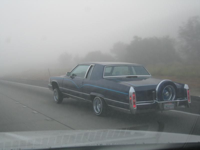

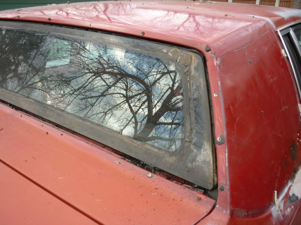

I removed my vinyl top on my coupe and was wondering were do i get the trim for it so it the back window wont look so open?
Mines look like this
I want it to look like this

21,876 Posts
find a 4 door rwd sedan deville 80-89 with the no vinyl top or a coupe deville with a no vinyl to get the right glass, thats the the only way to get the bald look right, you alo need the trim and interior trim around the glass along with the clips
