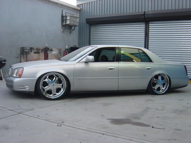

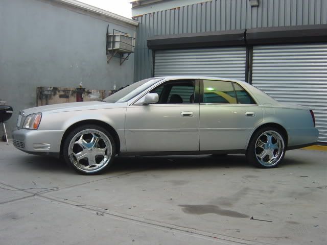

It's been a while since I have posted some recent work. Been super busy at the shop, but I think this one is worth showing. Its a complete build-up. Everything done in house. Came in stock and its leaving this week. Will eventually go to paint but we aren't getting involved in that on this one. Oh yea its on 22's and it drives layed out.

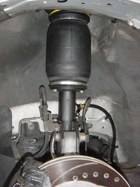

I never run passed 200 psi on any car that I use the Universal aero bags. That picture is with the suspension unloaded so its not a good way to judge how much lift it gets.

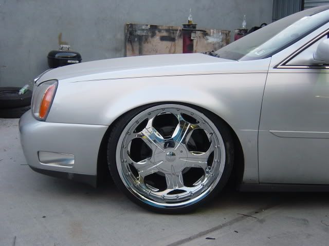

Not trying to nock you at all, but Is that the lowest the front can go with out rubbing or did the cust not want his car cut up?

When dealing with strut cars it is very difficult to get them as low as a car that has upper and lower control arms. I have gotten some cars to lay subframe with struts, but its not always possible. 22's and struts it a tough combination. Getting it to sit any lower wasn't a huge concern, but it would require quite a bit more work. As it is, it will be just as reliable as stock, so I think its a happy medium.

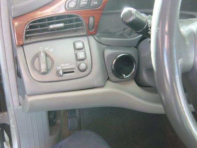

What is that next to the steering column and light switch in that one pic??

That small pod that I made next to the steering column is for the digital pressure gauge.
