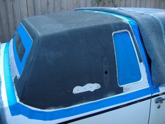

I get so many PM's on how it’s done. It’s not something simple like many seem to think... It’s a job that takes hands on experience. If you’re will to tackle the job here are a few pics to help. I didn’t take as many as I should have so if you guys have questions Ill do my best to answer them.
After the original top has been removed I repaired the damaged pading. I use a 36grit sanding disk (by hand) to scuff and shape the new fome pad.

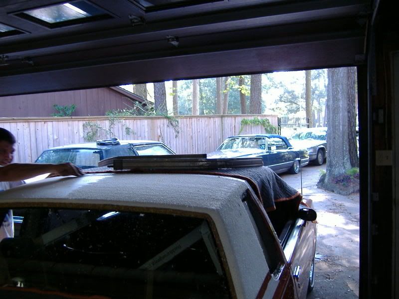

The car is them masked and glue is then sprayed using a gun and compressor.
The top is glued and then the top pad were the top is to be installed. (both surfaces)

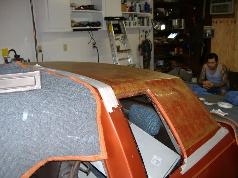

Here is a cutty with new pad being scuffed.
that your cadi in the driveway! :eek: :thumbsup:
