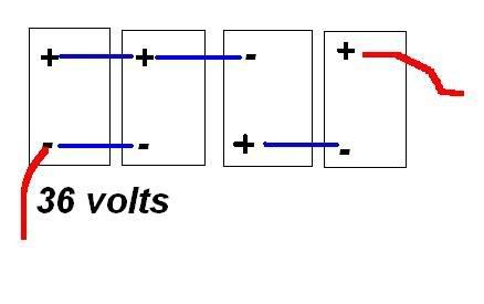

if u want them at 36 volts then just wire up 3 in series. or just do the 4 in series. ground position, then follow up with + to the next batteries - and so forth

i just saw the diagram again and his is at 48 volts ..i was thinking more to the 36 but 48 would work
14,802 Posts
which diagram r u refering too. cuz i was workin off the very 1st that the member who made the topic has posted that one is not wired in 48. but the one that DaLocstah posted is wired in 48

The very first one.. . 2 pumps at 36 volts works great like that.. Or 48 to the front and 36 to the rear. :biggrin: a lead off every postive ( after 12volt) battery basically. hahahha.

it has 2 diagrams, the first illustration is at 24v for each pump. 2nd illustration shows 48v.
6,202 Posts
TRY THIS !!!
36 VOLTS TO EACH PUMP !!
