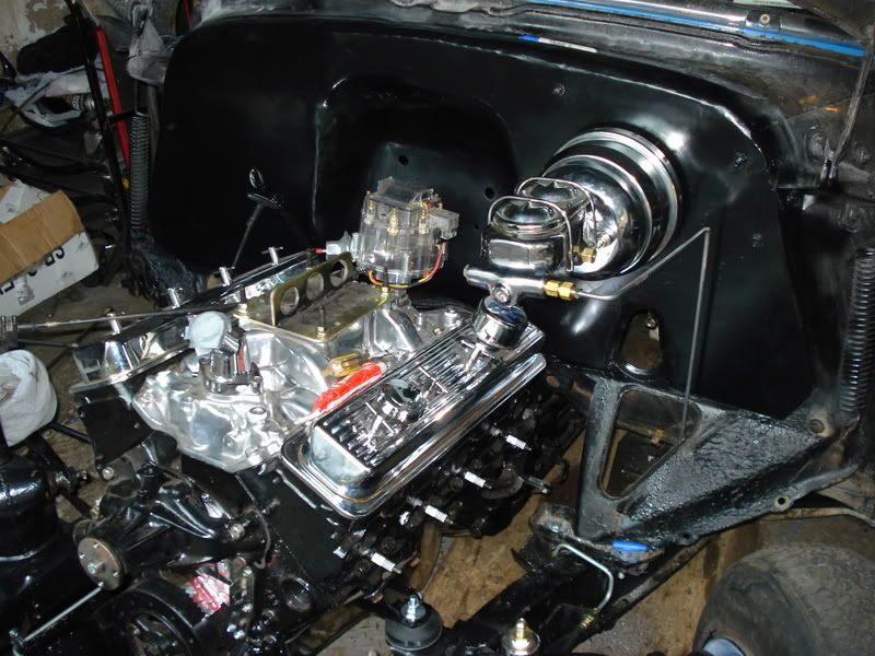

a freind of mine purchased some long water pump pulleys in chrome for my motor as a gift, but they dont fit. why??? i know i have a long water pump. its an 1989 chevy corvette block, i actually replaced the waterpump with another brand new stock water pump. the bottom pulley which is the crank pulley seems so long that even if i get the top pulley that doesnt fit to fit,, the belt grooves will not match. the top pulley doesnt fit over the center hole. any help??? thanks guys!
heres a pic

If you got a water pump for a corvette. the shaft on it will be bigger then a non corvette water pump.

FROM HERE IT LOOKS LIKE A SHORT PUMP NOT A LONG. NO BIGGIE, JUST BUY A NEW PUMP :cool:

so u guys think its a short water pump?? i could have sworn i bought a long,, but i am positive that it was the stock pump i bought! i dont know,, yea maybe i will try different pulleys, u think its suppose to be a long water pump???? on or is it how can i tell??

It does look short in the pics. Post a couple more pics of it.

It totally looks like a short water pump in the pictures.
