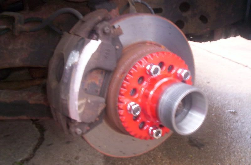

I've got a '94 Caprice with 4 wheel disc brakes and i still had to grind both the front and back calipers to fit my Daytons. ;) Now, my homie has the same car but with drums in the back and all we did was grind the front and install 1/4" spacers, nothing on the rear. 13's are not going to fit if you've got 4 wheel disc brakes.
Here's a front caliper, you can see where i grinded.
Tires are 195/75 14 just for reference. 175's don't give me enough traction and have the car sitting too low.

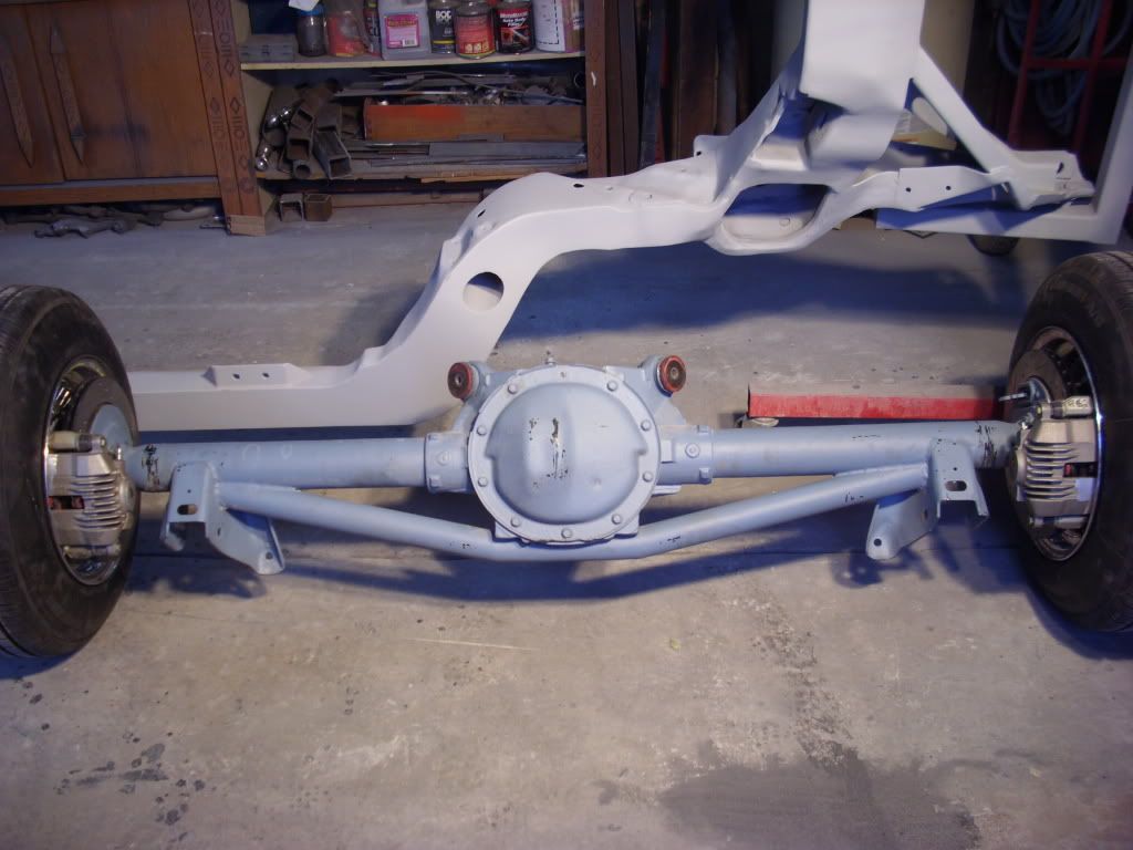

I forgot to clarify a little detail. Front wont be a problem. I'm actually building a 1968 Impala, and will be using a 1996 impala rear end. (for better travel and elimination of the pan-hard)
Since the diff did not came with the caliper from the salvage yard, I had to buy new ones, plus I was planning to get them chrome out. That's why I was not convice about grinding them.

Well i'm sure i could have used 1/4" spacers in the back, if that helps. I barely grinded at all in the back. If you're planning on chrome plating, i would just grind down more than enough and make it real smooth before sending to the plater. :biggrin: Don't forget to add 2 bottles of the limited slip additive if you're changing out the diff fluid ;)

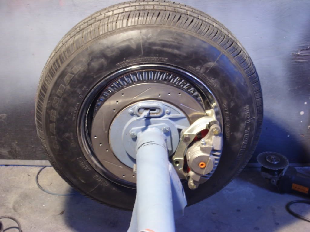

the 13'' now fit, even with those big ass calipers. I had to use spacers(like suggested earlier :biggrin: ) and cut/grind about 1/4'' off the calipers.
It did not feel right to hack these brand new parts but there is no way i'm running 14''
