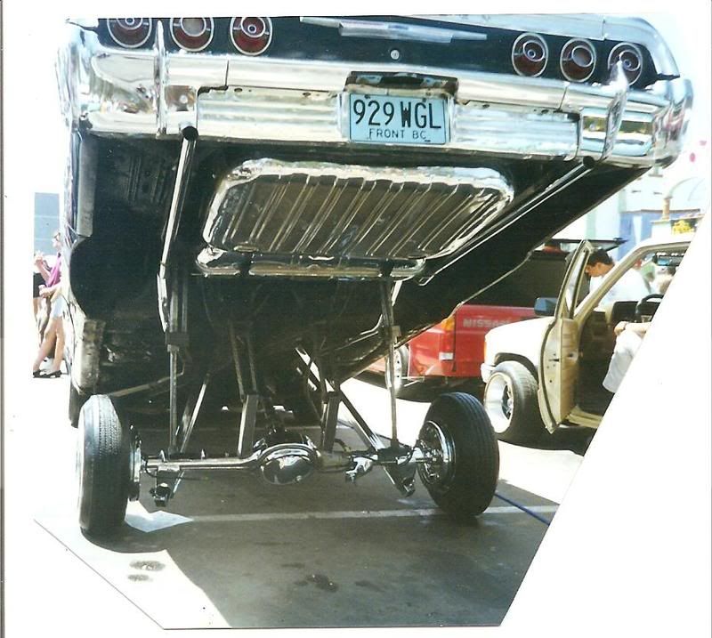

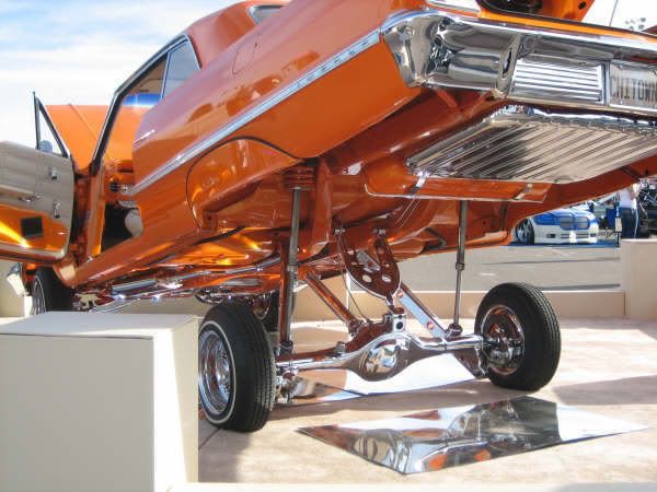

where and how are the cups mounted on these cylinders are they just welded higher up on the cylinder?
· Phoenix Chapter President
6,817 Posts
There not welded they slide on the cylinder upside down,there just reverse cups(where the springs are),.........
1,293 Posts
thanks man
9,138 Posts
You can roll like that but need a telescopic driveline. But I would drive it like that on the freeway. We do it to gas hop.
