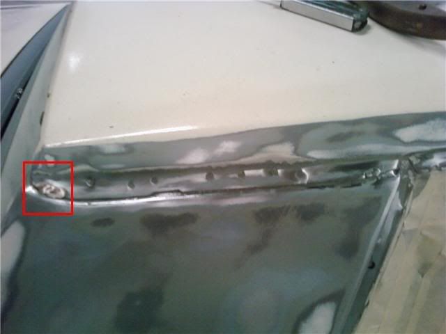

a while back I removed the vinyl top on my cutlass and I noticed that only on the drivers side pillar, where the roof and quarter panel seam is, I had some soft metal filler, did GM use lead in the 80's???? I thought lead was old technology only used on older cars and that they'd stop using it on later cars since it's toxic...I know they make a lead free body solder but I'm just curious to what I'm dealing with since I've used a angle grinder on it and they say not sand lead, tho i am using googles and respirator anytime I sand anything...I need to remove some of it since I have a stress crack i guess from when the door slams, I'm gonna fill it wit fiberglass bondo, it worked on the other side so i'm gonna do the same

it looks like a good 3x3 inch piece was filled with lead but only on the drivers side....yeah the sail panel near the edge has some brass brazing on it, it looks like a lil gold nugget...
the brass brazing...GM really did a shitty ass job joining these panels together didn't they :mad:
you can kinda see the lead its below the gap....yeah I tried to "V" it before but I just used filler, prob gonna cut a bigger V and use fiberglass filler then finish with glaze but I don't wanna melt it all out that seems like too much trouble and might warp it
jus weld the seam across all the wat around that way u wont have any issues trust me been there and done that espicially if your gonna juice the car
