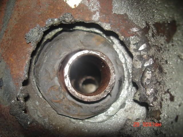

That jagged edge of old frame is mangling the bottom cushion of the bodymount. I'm sure it not mounting flush and letting that point flex.
If I cut that jagged part out will it correct the problem?

ouch,maybe a "washer" to keep it from going inside?!
14,802 Posts
id lower the frame out from under the car and fix that

Dropping the frame isnt gonna make it more accessible. The frame is wrapped and smoothed.
Gonna have to find another way....

did it mess the qtrs up? no tellin if thats the prob,but it wouldnt hurt to fix that! btw, whys it say your banned?

Yes it fucked my quarter up.

aww that suck ass that its alreayd smoothed out and wrapped. i would put a washer inside like another member posted

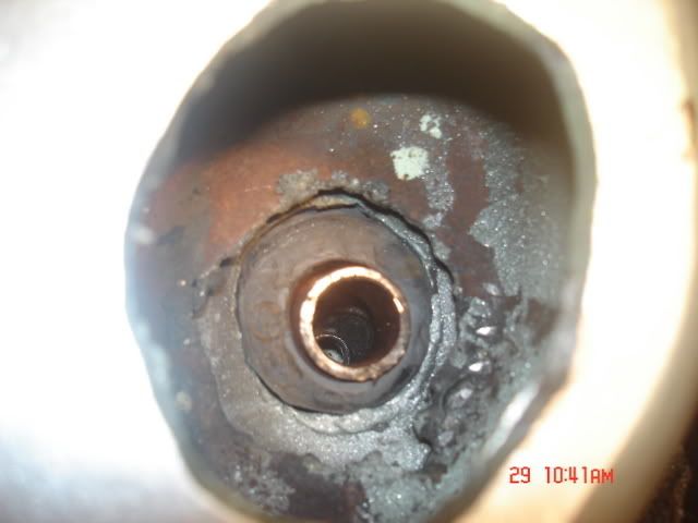

A dremel is opening that hole up enough so the bushing will fit against the "new" steel on top.
Just time and effort.

It worked. Or so it seems. The bushing now rests on the flat part of the new steel....

ya that word work too. sometimes the obvious fixes arent always the first lol. but opening up the hole and adding metal would definately help that. i would try to sand that rust off as much as u can and spray that area with rustolemum. if i spelled that correctly, so that it will turn the rust into primer and seal

god damn, that shit looks like the cookie monster took a bite out of it! TRim and smooth them jagged edges with a carbide bit they are defianatly keeping the bodymount from sitting flush in the hole! I had to take a carbide bit to all mine as well, you want it smooth and circular as possible!! :cool:

Damn that sucks, yeah anytime a frame is wrapped its always a good idea to smooth out the body mount holes so the bushings wont get mauled, most likely the person doing the frame wont, all they do is cut em with a plasma and thats it!
