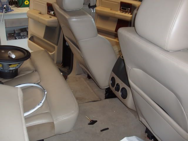

Ok so, sporty, brian, hitman or any one else feel free to chime in and give some opinions on this idea as long as they aren't retarted. This is the rear space i have to work with, my buddy doesnt want to put any speakers under the seat where they can get kicked or have junk pile on them, he wants to keep the integrity of the console and all the factory panels so...
This is the space,

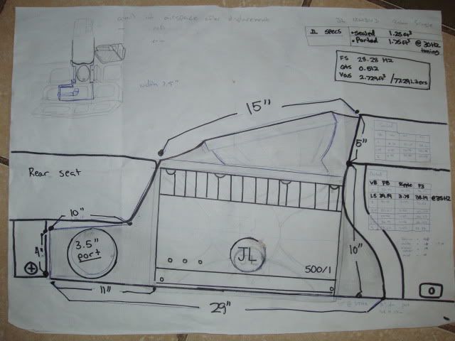

This is what i came up with and he likes the idea visually but im seccond guessing the ammount of airspace and power output of the amp with a single 8 ohm speaker on it.
Anywho, heres my sketch with some measurements keep in mind the amps are mirrored so the 500/1 is on one side and a 300/4 on the other. between the amps there is 7.5 inches externaly and between any other part of the box is about 12 inches externally.
Jl recommends 1.75 ft^3 ported tuned to 30hz, i can get roughly 1.5 ft^3 with out making the box into an L shape under the seat. When i did my own calculations with the speaker parameters at 1.5ft^3 i get an Fb of 34.14hz a ripple at 3.78 and an F3 at 38.14hz i was going to tune it at 35hz with a 3.5" pipe.
Heres the specs i came up with, if you cant read them i can type them just ask.
Soooo... basically, with all the techno numbers and before i start building this tomorrow do you all think that L'ing the box to get up to 2 ft^3 would even be worth it, even at 2 ft^3 the f3 only drops to from about 38 to 33hz, and being a single 8 ohm speaker on the 500/1 is this going to be worth all the extra effort.
Any input or ideas would be great

There really wasn't enough space to have the speaker down firing and raised off the floor and still be able to get the 1.5 cubes we found out later, and if we would have L'd the box there wouldn't be enough room for the port, the port is going to be on the driver side under the seat outside the box firing towards the side panel.
