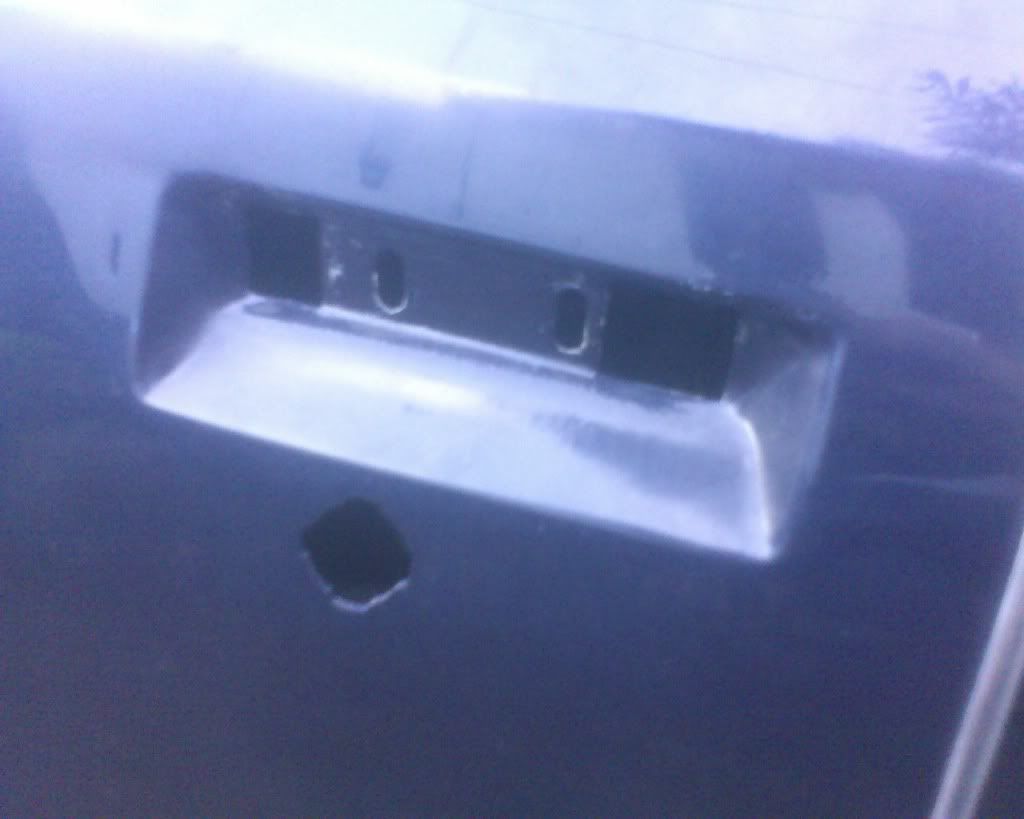

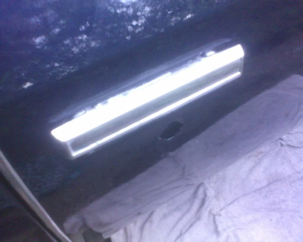

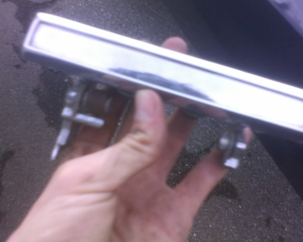

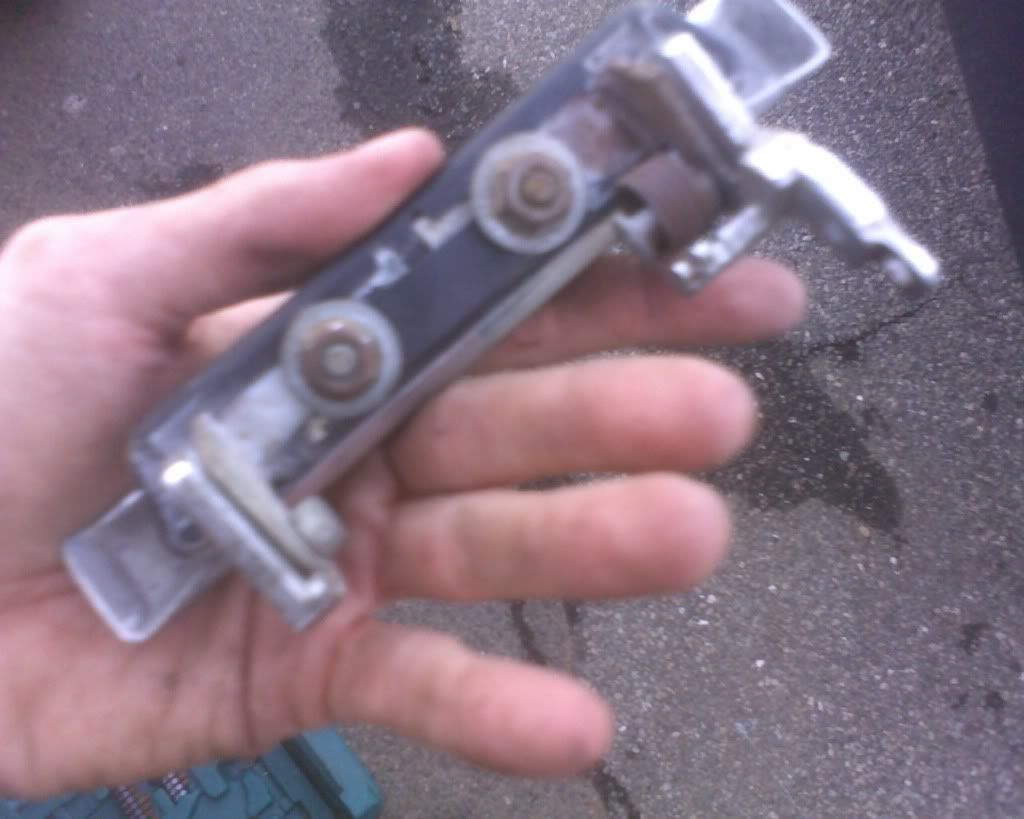

i tried the maintenance forum but no ones ever in there
bought the car with them off, i can get them on but they dont open the door.
whats the trick?

you need the metal rods that actuate the locking mechanism
2,037 Posts
would they still be in the door? or do i need to find them then attach them to the handles before i put them on?
3,157 Posts
whats the trick?
YOU see that little hole that has the little white plastic,
a rod goes in there and goes down to the latch,
when you pull up on the door handle, it pushes down on the latch and opens the door
if you dont have one, your going to have to go get one
it might be in the door, cause you have to lift it up so that the rod comes off
