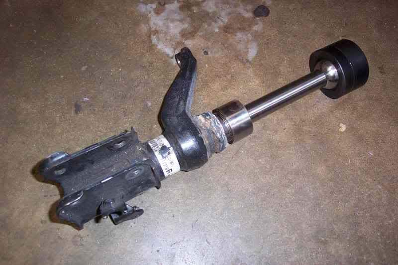

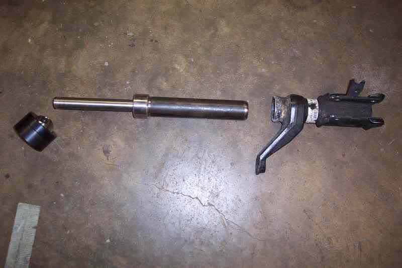

well im building my mac struts for my ride , help comments or questions before i weld them up lmk

should be no problems , looks pretty good welding on the cyl casing is kinda iffy.
238 Posts
looks alright. might have been easier to go with cylinders with the side fitting. but as long as you got that bottom fitting sorted should be alright. make sure to leave slack in the hose obviously

you might want to weld some nuts to the sides of the casing to thread some bolts through to hold the cylinder in place. it looks like it would want to pull the cylinder up out of the strut casing if you were to jack up the car.

well i think ima drill some holes and plug weld the cylinder inside the casing aslong as the sleeve unscrews to remove the seals shouldnt have any problems? anyone ever have problems welding on a cylinder?
11,533 Posts
make sure the steering does not make the stroke and casing turn separate...u always want the cylinder to not turn
