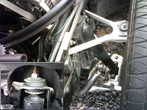

Well, im interested in both front and back. But what bothers me is that there is no coil overs to place the cylander in, its just two A-ARM looking supports with a shock mounted in the middle. I know there are hydraulic cylandars that are specifically designed to be bolted on at both ends, I was just seeing if I could still get away with the #8 cylanders I already have. It would really suck if I had to get new cylanders...but I know thats the cost sometimes.
Perhaps I should take a couple of pics of the suspension and post it, i'll get to that as soon as its light outside.
2,530 Posts
Ok, here are some pics of my suspension in the front. Tell me your ideas on how to get my cylanders on.

1,968 Posts
just like this would be the easyest way ;)

2,530 Posts
Just what I was looking for!
Kickass forum you all got here!
Now I just need to fab up a top mount, so the cylander can free float around while in motion. I was figuring it was close to that design as posted, but wanted to make sure.
One thing I do need is a source for material for the bottom of the cylander mount to the lower a-arm. I forget what kind of joint, I use, its called a hime joint, right? Im rusty on my hydro lingo :(

22,931 Posts
yes either a hime joint or a power ball....but a power ball would allow the cylinder to move around ..so in the front probly best to use a hime joint
