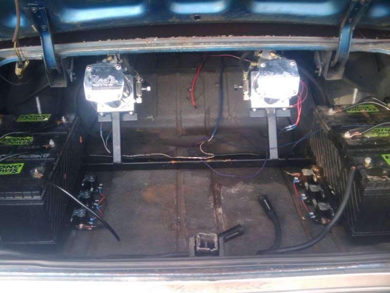

I CHANGED MY SOLENOIDS TODAY. THEN I DECIDED TO TAKE THE TERMINALS OFF MY BATTERIES TO CLEAN THEM. I THOUGHT I HAD THEM BACK TOGETHER PROPERLY BUT APPERANTLY NOT!!!! :0 WHEN I TRYED TO PLUG IN MY 2 MAIN CABLES FROM ONE BATTERY TO THE OTHER SIDE MAIN CABLE IT SPARKS!!!
some one PLEASE HELP ME

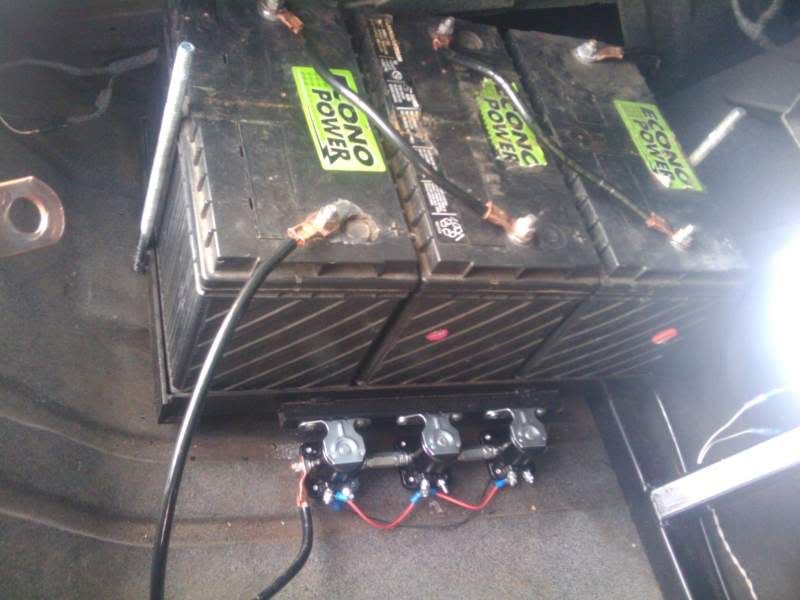

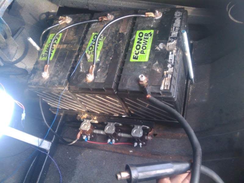

as you are looking at it
left side (this is the side wehre i replaced the solenoids, and cleaned the terminals)
right side... i didnt touch it at all
48 Posts
as you are looking at it:
left side (dchanged the solenoids and cleaned the terminals)
right side... untouched
1,758 Posts
first off the quick disconect ends are backwards in case of that one with the male side hits metal it will make contact and then on the last picture of the batts and the solenoids looks like the terminal by the disconect on the solenoids is too close to the metal maybe thats why it sparked check that if not you provably got a switch stuck or just bad check your switches
