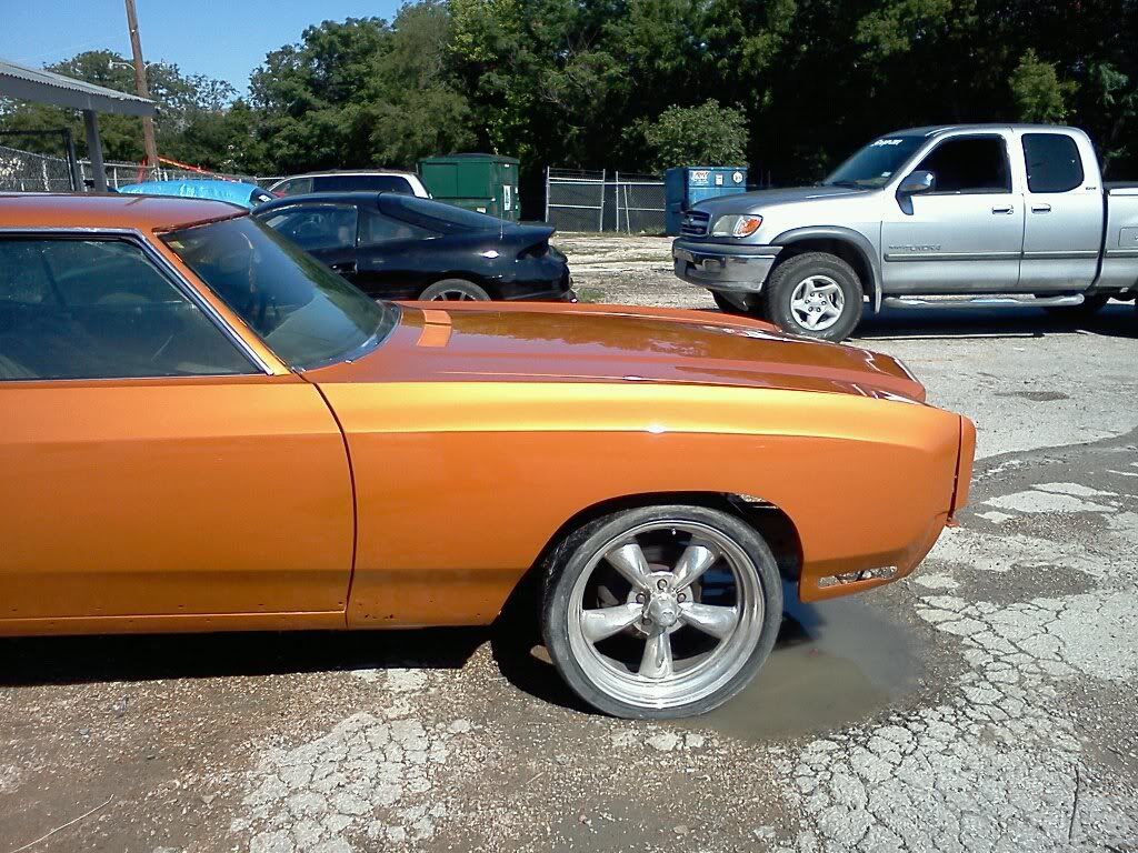

my car was painted a couple of months ago and it doesnt have the glass look I want. I dont want to do any sanding unless i reclear it because i am not sure how much he sprayed on it. I have waxed the car twice since i got it back. any help is appreciated.
13,097 Posts
Wash with dish detergent several times and let dry.pull into the shop and wipe with wax grease remover,scuff with 400- 800g .tape the car and spray your clear

LIke stated above,wash with wax and grease remover,and wetsand with 600-800 grit on a foam backer pad,re-shoot.
1,382 Posts
just try to cut and buff you ride. wet sand with 3000 grit and use compand. i use 3m compound. three steps and ur done. looks good

there is about a one inch spot on a crease that looks dull. I dont think there is enough for that. what kind of detergant should I use, comet our ajax?
100 Posts
thanks guys this did help. this is my daily so i think i will do it next weekend if i can finish cleaning out my garage. im thinking wash a few times with dawn, wax and grease remover, wet sand with 800, wax and grease remover again, tac it and i should be fine. i am just real worried about the wax.
