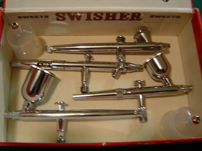

I HAVE ALL THESE AND I CAN'T FIND ONE THAT DOES BOTH. IT'S EITHER OR.

If you want to draw and do artwork, your going to need something like pictured above ;)
