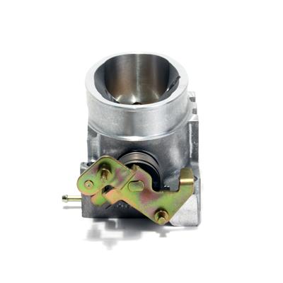

i got a 94 cadillac fleetwood brougham with the corvette lt1 motor. my question is where can i get the chrome lt1 fuel rail covers they make for the vette also will the corvette throttle body and intake fit since its the same motor. here is the pics...
here is the pic of the throttle body and intake

You don't need that BBK throttle body unless you have have done SERIOUS (cam, rockers, springs, headers, exhaust, etc) mods. The stock throttle body will be fine. Where does the MAF go on that crazy three filter setup? On the stock B or D body, the MAF is all the way over on the left. On the SS in your pic, the MAF has been relocated to right in front of the TB. You need a MAF wire extension to do that. I use a K&N FIPK on my SS, and I am very happy with it. If you use that tripple filter setup, you will be just sucking in hot air that has just passed through the rad - not a good thing for performance.

My buddy said that intake might be for the 1992-93 Corvette without MAF. Either way, it's ugly as sin IMHO.
