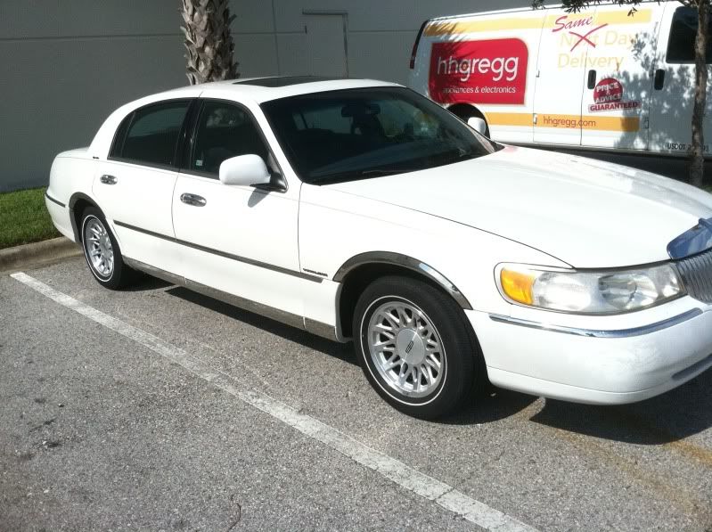

was just gonna daily it but i went ahead and did the spindle swap. while i was doing that i added reinforced lowers and 1 1/2 inch extended uppers
the extention was way to much for me and i took them off and extended some other ones i had only 1/2 inch.
Brougham
2,240 Posts
i went this far so i went ahead and cut it out. i put 6 inch up front 14s out back w/powerballs. at this time i just happend to run across a wrecked 04 limo and i grabbed the front clip off it.... and i bought another caddy
i started to tear down the car

Did you do anything to the core support for the new front clip?
Yea I used the bottom half of the og 98 core support, and basically welded that to the 04 support,also had to use the hood hinge both halfs from the 04 to get the hood to close.

Thats how I did mine. I was told by a couple of people that they just modified the way the 03-10 hood hindges fit on to there 98-02 core support.
yea i prolly should have done it that way. theres a little piece of metal on the 98 support that u would have to chop off. o-well its done now urs is gonna look real nice that grey color.
