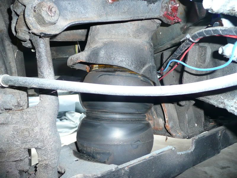

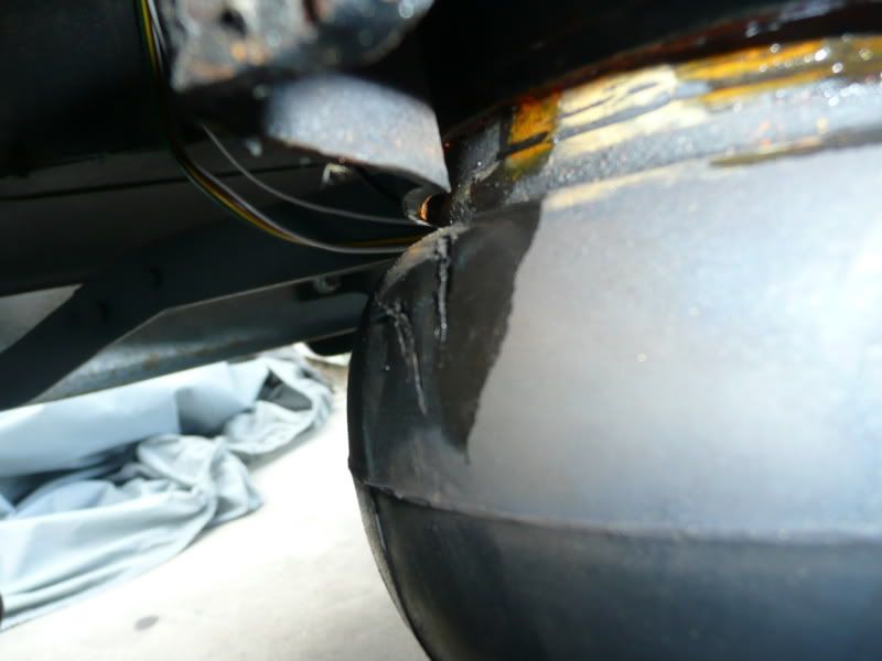

i was checking my suspension yesterday and i saw this :mad: The front Driver side bag is fukkin' rubbing against the round cup... What do i need to do?
:mad:
How thick are these bags? It's eventually gonna cut through this bissshh right!!?

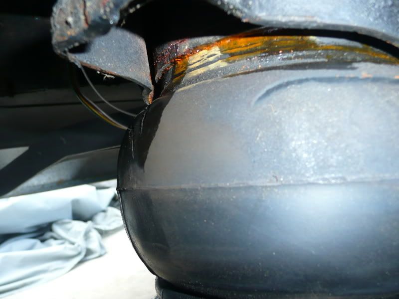

This area looks like it needs to be shaved off a little bit too right? as you can see the mark there where it rubs.
9,605 Posts
yeah i was gonna say dont leave out the bottom homie
id replace the bags too if there are gashes in them like that..
cut and weld, then smooth it out

Yes cut all that shit out and replace the bag like todd said.Keep that bag for a back up just in case

FUCK NO you should not pay for shit.They should have knew that was rubbing

I'd still trim it back

whoa, that pic with it dumped is scary! get that fixed asap! that reminds me... i should prolly check mine in the near future :cheesy:
144 Posts
can u get a smaller bag in there and trim it? id trim that bitch as far is you can withought taking away to much strength. theres a whole lot of rubbin and pinchin goin on in there.

I dont think i'd go any smaller that would require more PSI to lift.If anything i'd go bigger cut out more and reinforce a little
