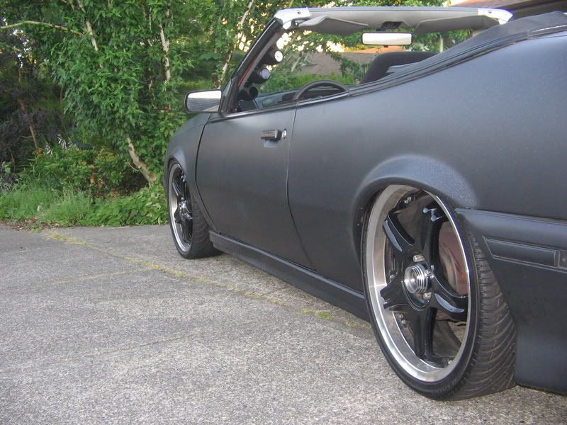

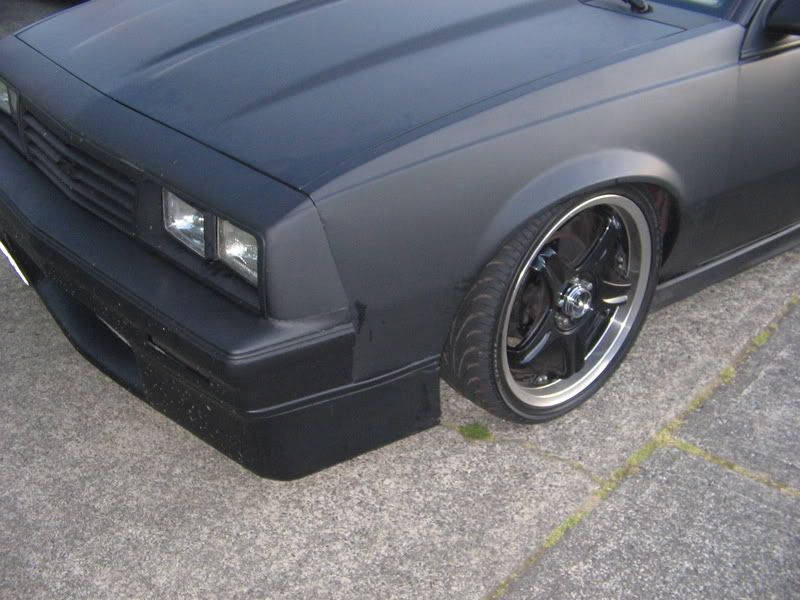

hey all got a 90 cavalier on airbags, problem is the front doesn't lay low enough for me.....:( i'm interested in entertaining any and all options to get the front as low as the rear..... i'm on 18's and the tire BARELY tucks on the fronts where as i'm almost tucking the lip of the rim in the rear....
i'm on "Stock" struts up front running a universal air sleeve bag.... if there's sleved bags that will compress further i'm open to that, also on the stock strut mouts still.... maybe something custom in that avenue...

Take some pics of what you have on there. Maybe a pic in the wheel well fully lifted to show tire to bag clearance, pull off a wheel to show the strut, then even on top to show the shock tower and upper mount. There a few tricks that we use to get strut cars lower. You can flip upper mounts, sometimes install it on top of the strut tower instead of under. Play around with bearing variations, and sometimes a shorter strut in place of the factory that will allow the suspension to compress more than the original strut allows.

inside edge of tire to bag mount 1/2 inch to 3/4 inch, i used my stock upper mount yes.

I have some pics of a car I just did with a custom upper mount. Take some pics of your sunbird if you want us to help. Without seeing the car we can only give general ideas. Ill post some pics tonight.
