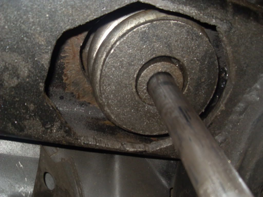

coils are breakin in
thats my 1st thought, or the powerballs themselves on the axle could be breakin the welds and sliding off..but i would think its the coils....Originally posted by Psycho631@Jan 3 2009, 08:15 PM~12596132
Originally posted by MonsterG@Jan 3 2009, 08:55 PM~12596454
its the upppers they is extended out, thats why it sits the pinion angle back, making the cylinders to be pushed up wards,when its dropped, and when lifted they is straight,how much coil do you got in it, ? :biggrin:
thats what it does on my bros lincoln having the uppers extended but dont hit the back of the seat cuz he gots 10s and almost a full stack, sits stock pulling down the cylinders, but if he was to get taller cylinders he would probably be having the same problem,
how old are the coils
and he is only running 2 turns of coil probably just broken downOriginally posted by AndrewH@Jan 3 2009, 11:00 PM~12597655
coils that short, and I'm guessing not shaved on both ends, usually dont level out very good, your coils have tjust rotated more than likely, which would cause your cylinder to slant at a different angle.
but i thought the uppers were already 1 inch extended all the way short,?Originally posted by white link 93@Jan 3 2009, 08:38 PM~12596866
naw powerballs welds are solid.... just at a weird angle when dumped
the coils are yrs old.... like 2 turns of coil
im thinking its the coils cause the adjustables uppers are at stock lenth not extend ... any other possible reasons??? ill post pics when it stops rain for better expalantion
its gonna have to be that or the power balls are welded on wrong position, check it they are straight when dumped,
looks like your coils may be a little problem make sure they both poin t to the same side last turn where you cut !!! but it also lo0oks like the uppers are way too open so either open more the lowers or close the uppers a little buit cus your rear end points up wards !!!! :biggrin:Originally posted by white link 93@Jan 4 2009, 12:50 PM~12601866
