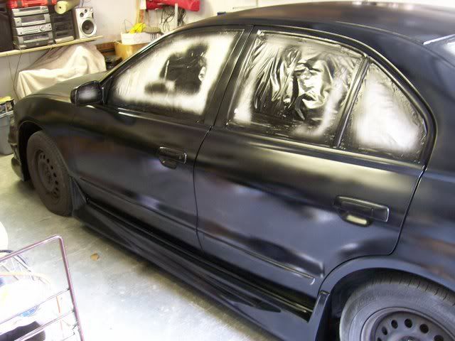

whats the point of using single stage if youre going to clear it anyway, lol.
looks like you sprayed it too thin/ dry. A nice wet coat would have dried with a nice gloss to it. Assuming the right reducing agent was used.

Didnt plan on clearing it I said he wants green pearl added now. I layed it wet and I had the reducer it came with when I orderd it. I also tried some wet look hardner cause I thought it was laying dull.
All that shit is irrelavent :biggrin: I need an answer to my question not a bunch of beat down comments
I try to mix in a few helpful comments with my verbal beatdowns :biggrin:
wetsand with 600. try to get most of the peel out but dont kill yourself over it. Then just spray and colorsand the clear like normal. :cool:
lmao... :cool:
So just wetsand 600 and clear?

I shoot SS black even if im clearing.  I would do a cople of coats of clear wet sand with 800-1000 shoot a dry coat of clear to get it tacky, a couple of medium coats with the green pearl.  a couple of medium coats of clear.  Reduce the clear a lil more than before and shoot one wet one
Im no stranger to painting, I just have never shot ss. I just was'nt sure if I should color sand then clear or color sand reshoot then clear.
Thanks for your help though homie

looks good.....I dont know why in the hell it looks so shitty but im gonna go ahead and clear it so I dont end up wetsanding reshooting then wetsanding and clearing anyways.
5,046 Posts
wetsand with 600-800 then shoot your pearl in intercoat, then hammer on some clear, next time you shoot SS, lay it down WET!!!!! and use SLOW reducer that shit dont run, also i lay down 3 coats usually, first one is tack coat, wait 5-10 mins, 2 and 3 are super wet with no flash between, just go around that mofo back to back!!

I swear I did lay it wet...as wet as I could without havin to worry about runs. My reducer was medium, I had good ventilation, I think I'll stick to bc/cc from now on.

dude, seriously SS for solid colors is easy as pie to spray, WAY easier than bc/cc, what brand did you use, i'm sorry, but those pics just look horrible, it looks dull as fuck, sorry it just does, its so bad i would really think you might have had bad hardner possibly????
