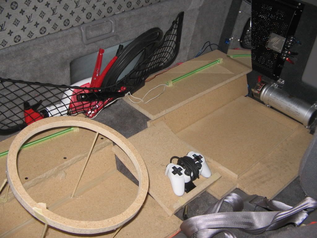

this will be my second fiberglass box, hopefully this time i learned my lesson and wont rush it.
but here it is so far, 2-12s on each side, ps2 in the middle, amp and cap are gonna be relocated, not sure where yet. prolly gonna port the boxes somehow also
and the old shitty box

3/8 MDF, home depot, $8 for a 4 foo by 8 foot sheet.
3,905 Posts
oops my bad, i ment 3/4

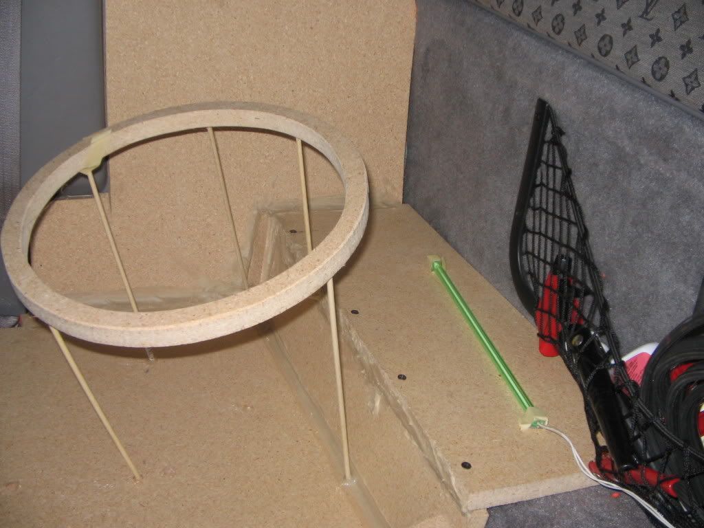

dam i layed my fleece down this afternoon, its all frankinstein lookin, i think tomorro ill lay the resin down and hopefully start glassin.

i left the wrinkles on top and on the bottom of the speaker rimg at the base. give it a lil more character.but back and side are nice and tight
i started layin the glass matt down today. ill post pix in a sec

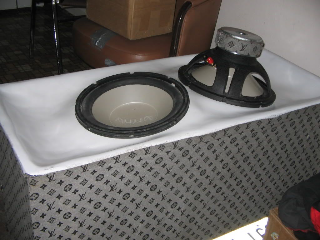

new pix, i need to hurry up and throw bondo and paint on this thing, im tired of that bright ass orange

yup, dowels are removed, and only the back side has been glassed, jus gotta make sure ur fleece is soaked with the resin, and you will have a nice hard base to start with, and once you glass it, it will be hard as a rock, i was able to stand on my other box
