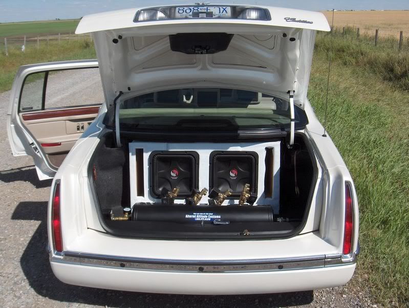

I have been riding this year with 1/2 DOT parker airlines. Im redoing the trunk to add a 42" Plasma and was just wondering what airline i should go with. I like the looks of the big hyraulic but how are the fittings for air for 90's and 45's to keep it tight and not dragging under the car or in the trunk and will they addapt to the current shit. I appreciate the feedback on this boys....

Bigger lines are definitely alot harder to route. They make bulkheads that will let you mount a fitting to the floor, then run the lines to that fixed fitting on either side of the floor or panel the bulkhead is mounted to. That will keep things neat going in and out of the trunk. The 90's and 45's come in either flares on either side or with NPT pipe threads on one side and flare on the other. Those lines have to be custom made with crimped ends, so its not something that you can do without special tools. They work fine with air, but it will be difficult to get everything in a nice compact space.
