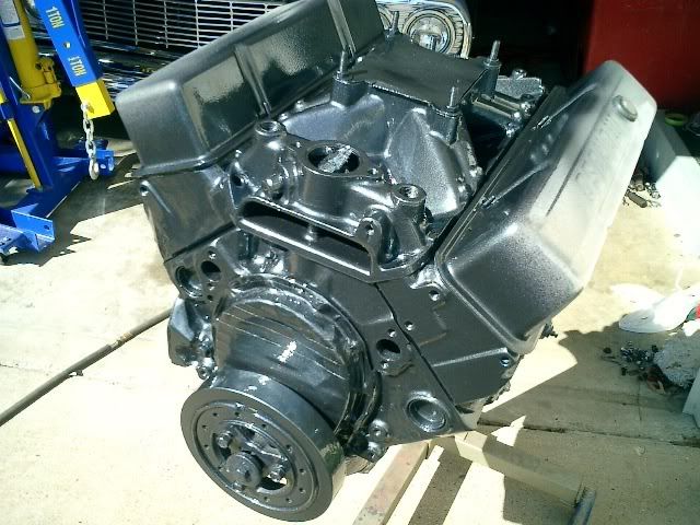

What makes little tiny air bubbles dry in clearcoat? I sprayed my engine block today and it looked sweet..... but now i see tiny air bubbles that dried in the clear. It didnt look like that when i sprayed it, but after drying for several hours i noticed it was covered with tiny white looking bubbles.... you can kinda feel them..... what happened?

They are really small air bubbles.... kinda looks like someone sprinkled salt in the clear or something.... kinda feels like it too. You gotta be really close to see them.
I was thinking..... its not like this all over the engine.... just on the front and the top on the intake.... the sides and back are still really slick..... i sprayed the clear until the gun ran out completely..... and im sure as i was using up the last of the clear i sprayed it on the front and top. Can spraying the clear until the gun runs out produce bubbles or something? It didnt look like this when i first sprayed it yesterday, unless i just didnt notice it because it was still wet?

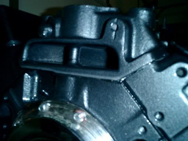

I tried to take pics from several different angles to show the air bubbles, its hard to see them, but you can tell theres so many that it kinda gives it a milky appearance.... you can really see them in this first pic on the front of the intake across bottom lip where the clear was thick.... and on the other pics, what looks like microflake.... thats the air bubbles.....
Let me know what you guys think. It really doesnt look that bad, im just picky.... should i just leave it alone, or how would i go about fixing it? I mean, its not like its a flat surface where i can sand down the clear.... and once i get everything on, it will be less noticeable.... but if i can fix it, i would like to.

Well, the part i dont understand is why it only did it on the front and top, and not on the sides and back? I mean, the sides and back look fucking wet man..... if i mixed something wrong wouldnt it be all over? Also, i painted it outside in the driveway, would it have anything to do with the sun? Im no professional painter, so these might be stupid questions. :happysad:
And even though you gotta have your face all up in it to see it... if theres a way to fix it.... yea, i would like to fix it.

The clear was some 5 year old PPG Del Glo DAU that i had left over and i mixed it with some Omni fast hardner.... 1 part clear, 1 part hardner, and i added maybe an inch of reducer into the mixing cup. This was all shit i just had laying around..... but why is it only on the front and top, and the sides and back show no signs of it whatsoever?

But it looks like that where there is no sag or run... look at the front of the cylinder head in the pic..... the camera flash caught it at the right angle and what looks like miniflake..... thats all air bubbles.... but theres no run there.... same thing on the top of the intake manifold.
But no matter what caused it..... youre saying i have to sand it down within the first 24 hours? Ugggh....

Yea, the front and top were getting the sun.... you can tell by the shadows in this pic. Maybe thats what happened? I let it sit just like this for about an hour after i was done before pushing it into the garage.
Shit, looks like i got some work to do then.... its only at about 20 hours ago right now..... what grit sand paper should i use? Do i sand it wet or dry?
