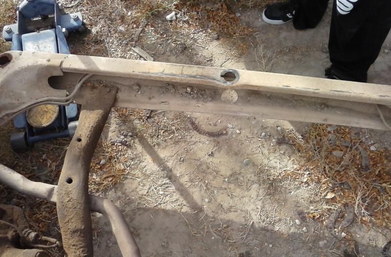

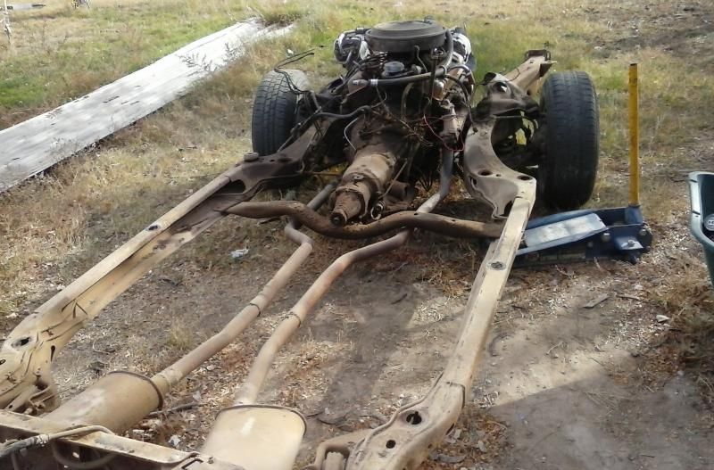

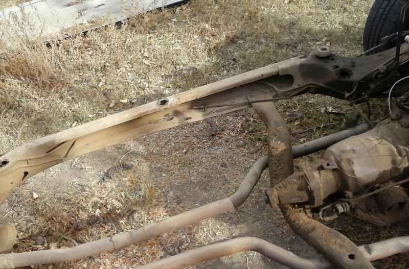

Can anyone tell me what would be the best way to box in this stupid frame. Also could use a few tips for reinforcing the frame in general and what not. Best type of welder to use for strongest welds. Thickness of sheet metal. Most crucial points etc. This will be my first time wrapping a frame. Any help appreciated.

Also wandering would it be better to re route the lines that run through the frame channel or make an access panel/opening to keep them inside the frame rails. Thanks guys.
#6 ·
keep the lines inside makes for a cleaner look. But if you do that run new lines. I would just leave enough room to be able to get it out later if need be. As for some tips the control arm areas need to have some gussets welded to them to keep them from cracking. Weld up the factory seams first then grind smooth then wrap the frame. Get a frame stand so it doesn't warp. Don't weld to much in one spot. keeps it from warping. this is a start. good luck.

If all ur doing is lay and play then just extend the upper a arms and reinforce the ears. It's a bigger car so maybe the rear arches as well to help prevent quarter panel buckling. I wouldn't run more than 48 volts by the way. Shit 36 is even enough..
#13 ·
IF you're gonna just be laying & playing just reinforce all of the stress. On the frame no need for a full wrap ?

Just want to box in the middle area and mold the frame to look smoove. I jumped on the rear arches and seent a little flex in that middle section so I that's the reason I figured it needed a little reinforcing there. other than that im cool with doing a partial wrap.
Is there any functional reason for the frame to have all the holes and openings, or is that just how the factory made them?
I know I need the holes for the body mounts and what not but I cant see any reason for the others being there.

Im doing a frame swap all right. Stock 77 frame to a boxed and reinforced 76 frame. No 06 frame swap here sorry hehe. Maybe on the next build.
