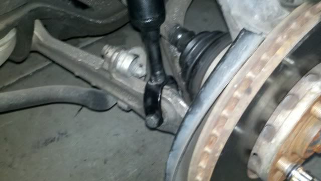

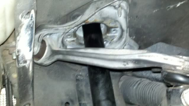

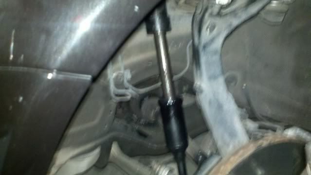

I just got the passat back from the stereo shop and body shop. I gutted all the air bags out and started working on the suspension. I used the factory strut bottoms and welded in a Honda cup. The tops are drilled out to allow the cylinder to come through. Instead of using the threaded cylinders I used a 1-1/2" cylinder with a sleeve slid over the top. I also got the motor caps, blocks, manifolds, ect powder coated a candy red to match the future new paint job. I should have the car operational within a week.

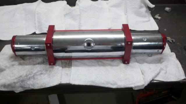

Looks good Jeremy. Are you going to be able to fit that 4th tank rod on there with your relocated filler hole?
That one will most likely be left out, depending on how much the filler is turned.

Looking good. I like how the copper tube looks. You plan on doing any sort if insulation covering on it or just leaving it bare?
