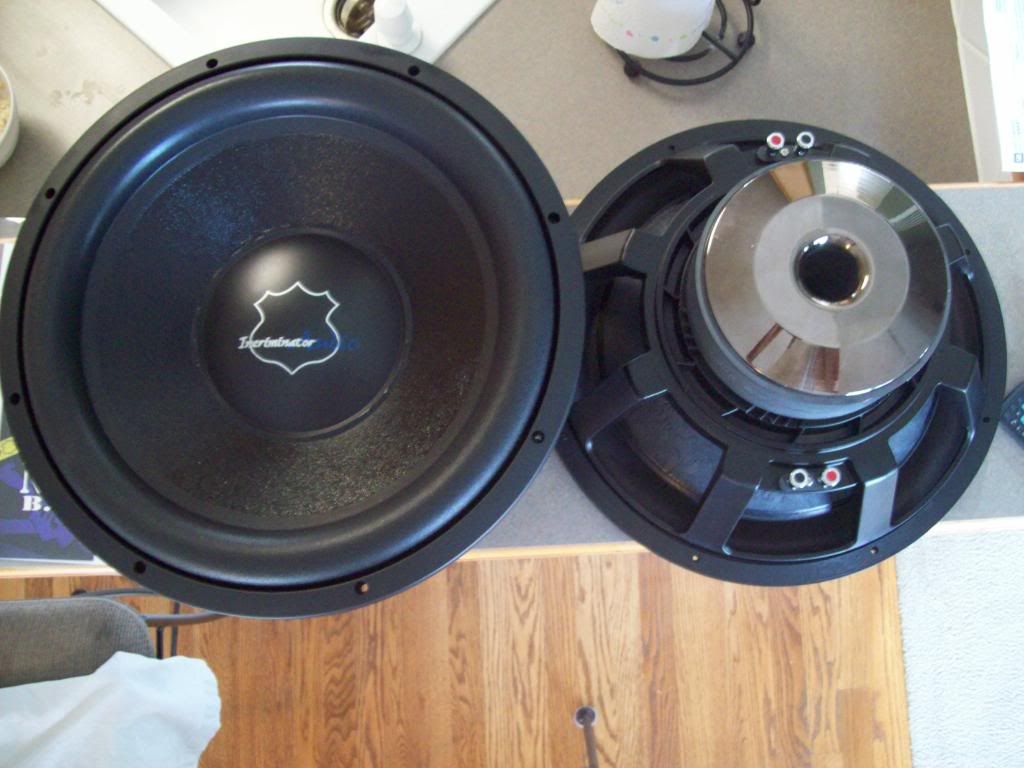

My15s are here yaaaa
BIG lethal injection 15s

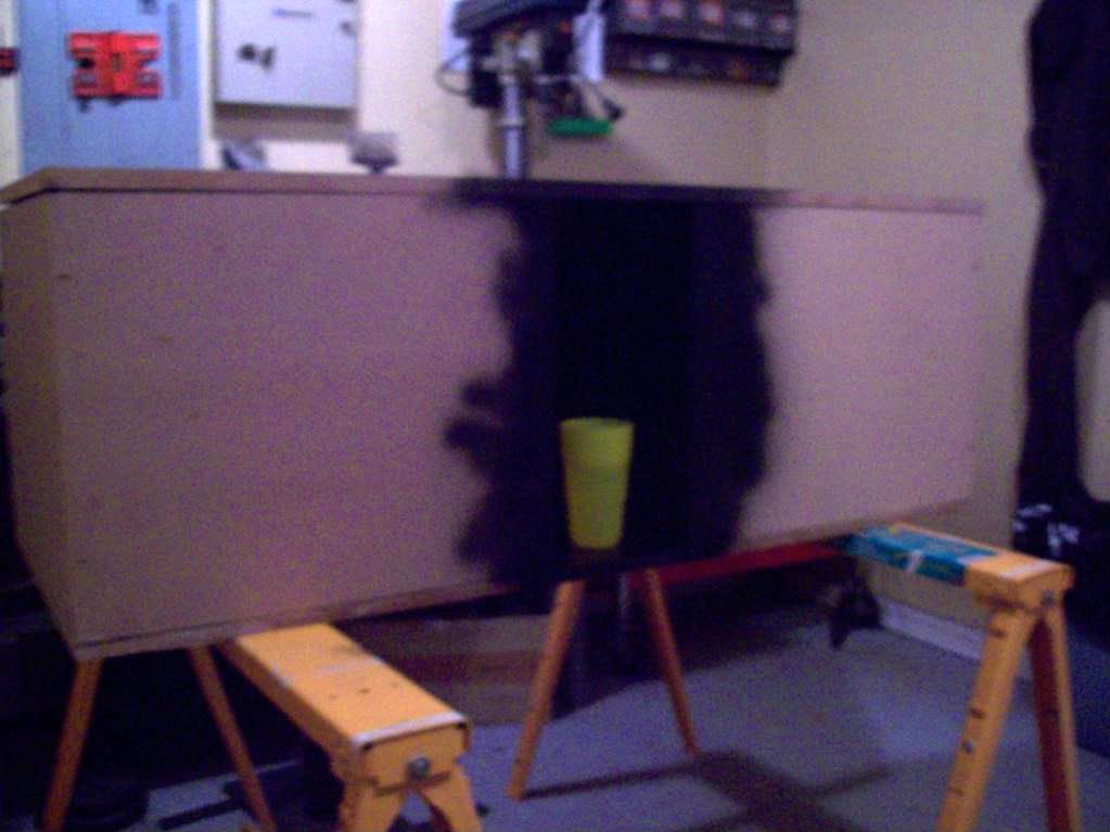

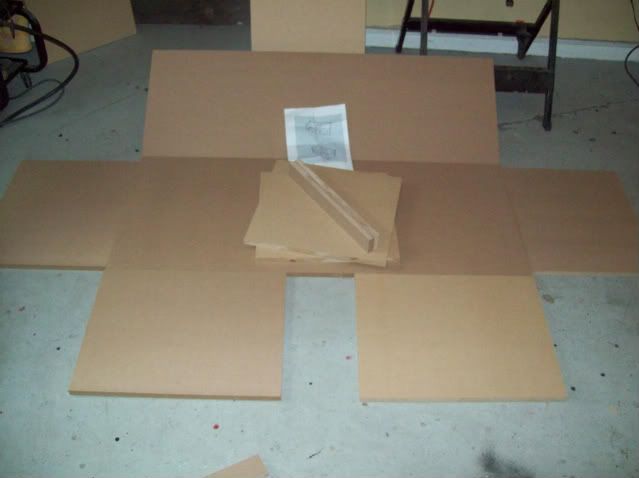

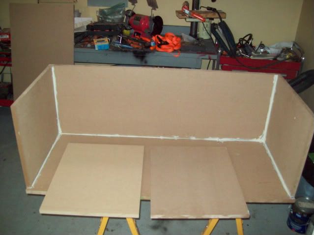

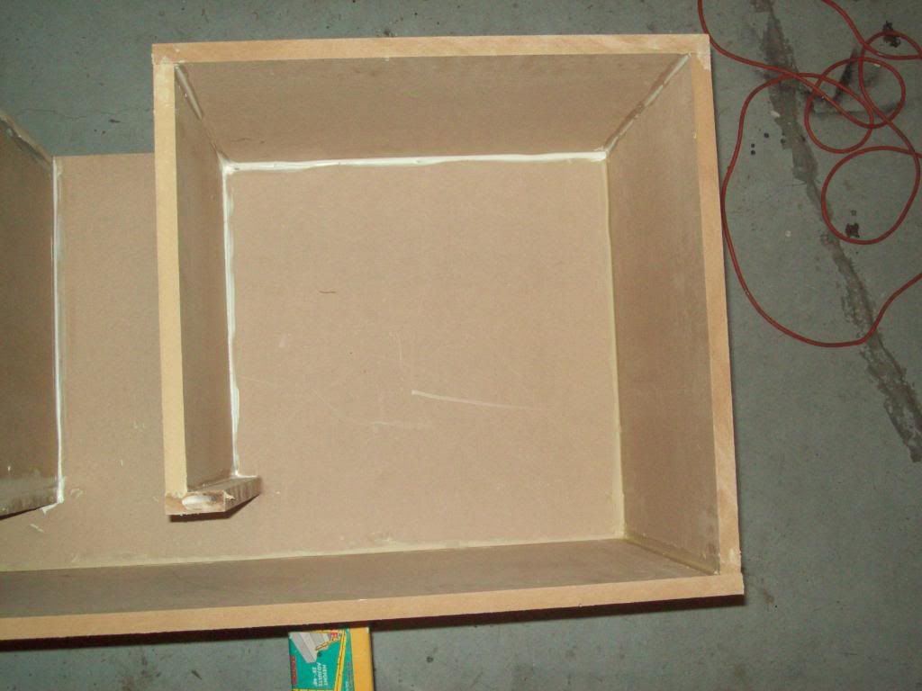

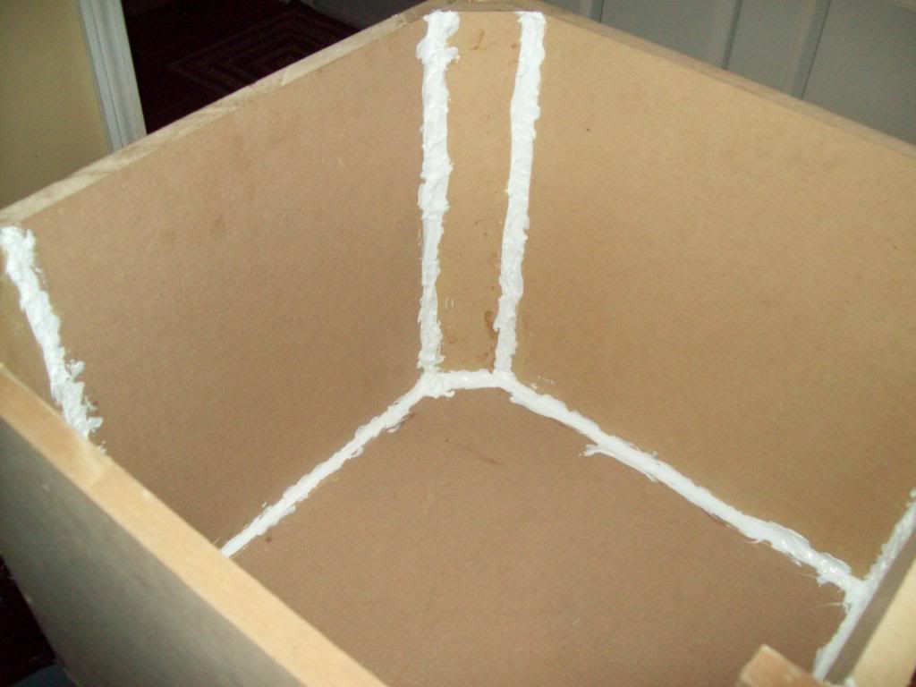

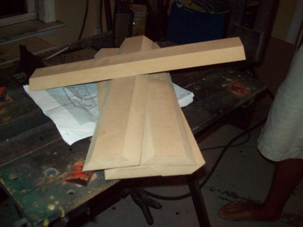

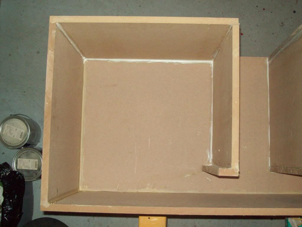

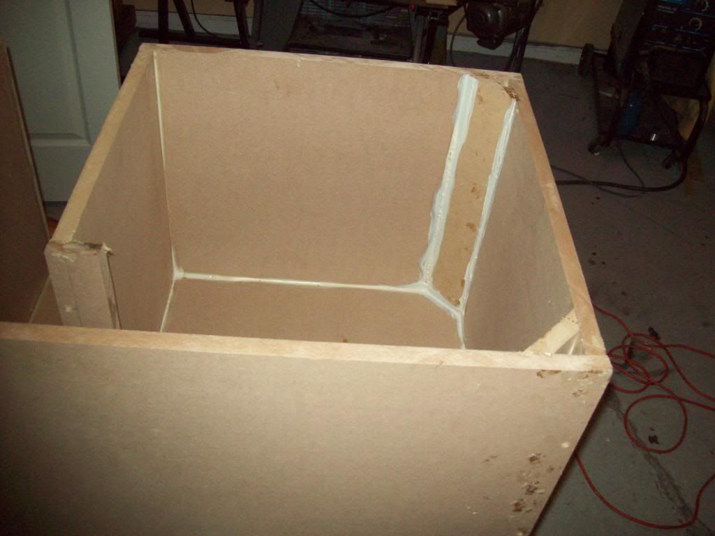

Got the 1/2 and 1inch MDF board adn cut so ready to build doing a center port box 8 cubic feet and tuned to 32hz
Time for the 45s
and the center port painted black for looks

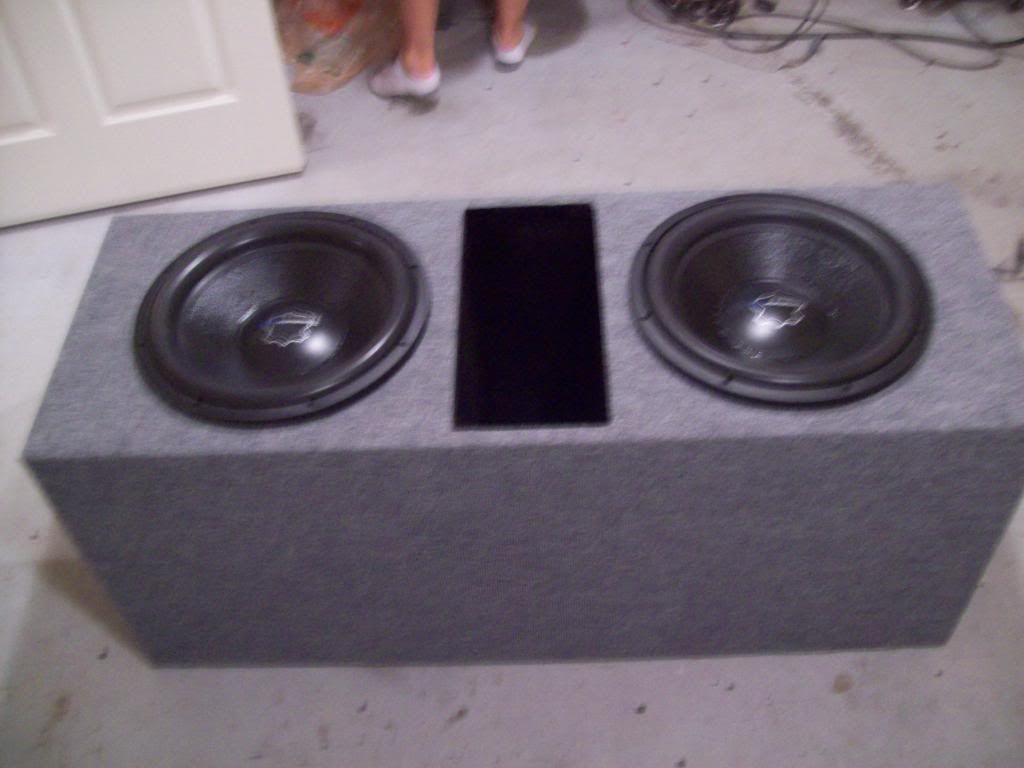

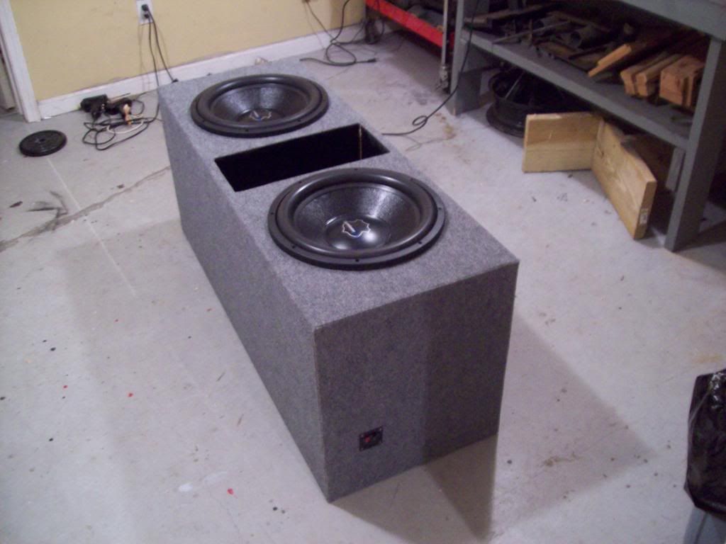

ANd Done

2 I hope you ment 8^ft for both subs, otherwise your power handling will be shit and those subs will assplode...
nice work on the box
777 Posts
Amp works great and i really do not need anything bigger and thanks man it was my first box and turned out great
