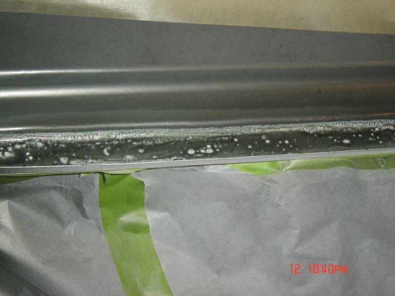

The trunk jambs on my caddy are giving me hell tonight, it looks like fisheye everywhere. I degreased it 3 times before I started spraying so it was clean. Im using Diamont basecoat and I reduced it a couple of months ago when I did my door jambs, would that cause this?

degresser aint gon work.. clean it with thinner..
scuff it up real good...
clean it with wax and grease remover...
make sure fully dry..
tack cloth it and base..
but dont base heavy... light coats
then clear

I Meant to say wax and grease remover, and I used a tack rag. And that is three coats of base because after I sprayed my first coat and it fisheyed I just kept going to see if it would even try to cover.
I've been painting off and on for 4 years I've just never had this happen before, the doorjambs went great on this car

I ALWAYS USE SANDFIX ON MY DOOR JAMS WITH A SCOTCH BRITE. BY GLASSURIT ITS A SANDING PASTE WITH ACIDS SO IT CLEANS THEM PRETTY GOOD THEN I SAND THEM WITH 600 GRIT SAND PAPER. THEN CLEAN THEM WITH 909 PREP CLEANER ,LOOKS LIKE U HAD CONTAMINATION IN THE JAMS I WOULD JUST THROW SOME FISH EYE ELIMINATOR IN A LITTLE BIT OF PAINT AND MIST IT ON THE JAMS NOT WET ON WET.

After it happened that time I took rag with thinner and wiped the paint off , let it sit for an hour and resanded, cleaned it and the same shit happened. I thin it really was drowned in armorall
I USED TO CLEAN ALL MY CARS WITH THINNER BUT ITS ALL IN THE PREPARATION NOW.
