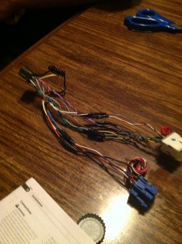

i have a 1996 fleetwood and nobody sells a aftermarket wiring harness for it. it has a shit load of wiring but i can't figure it out. can anybody help me out , i am gfonna wire it right in the factory plug. i did find 1 power wire but thats it. i can't find the remote wire power antena wire or nothing. thanks ahead of time. oh and the wires are in 2 seperate plugs for power and speakers so i have them seperate already.

Is it a BOSE system? Does it have the 32pin blue harness or the 21pin black harness. if it is the 32 pin there is no acc wire on that plug, you see where the thicker orange wire is on one end there should be a Yellow wire next to it, if there is no wire next to it then this is a 1st generation Databus that GM started in the Cadillacs. You can go the ign switch and tag on the the thick brown for an acc for the radio. the remote/power antenna should be pink. If you can post a pic of the harness I may have a better idea.

i found these 2 wires under the dash, this is what i needed to do. thanks homie, i appreciate all the help guys. :biggrin:

here e pics of plug i pulled it out of my 93 i have another 93 so its going in soon got from circuit city in 97.black wires go to amp speaker posts plug ties in to speaker harness and runs factory speakers.

There is absolutely no need to purchase any aftermarket harness for the 1996. Furthermore, the kits they sell advertised as 93-96 are ONLY good for 93-95. There is no amp in the trunk, it was on the side of the head unit in 1996. This has truly been a learning experience!!
I used the clips from the factory radio and spliced the aftermarket harness into the clips. The link above has all the colors decoded.
